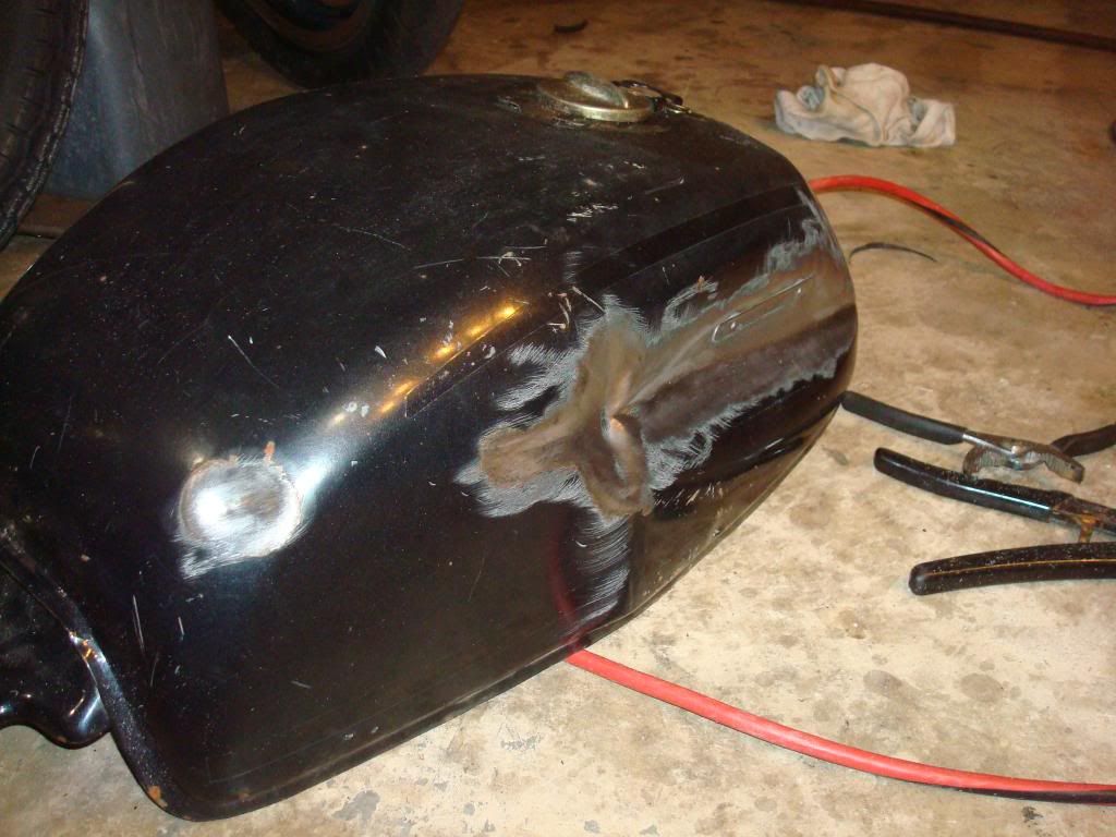

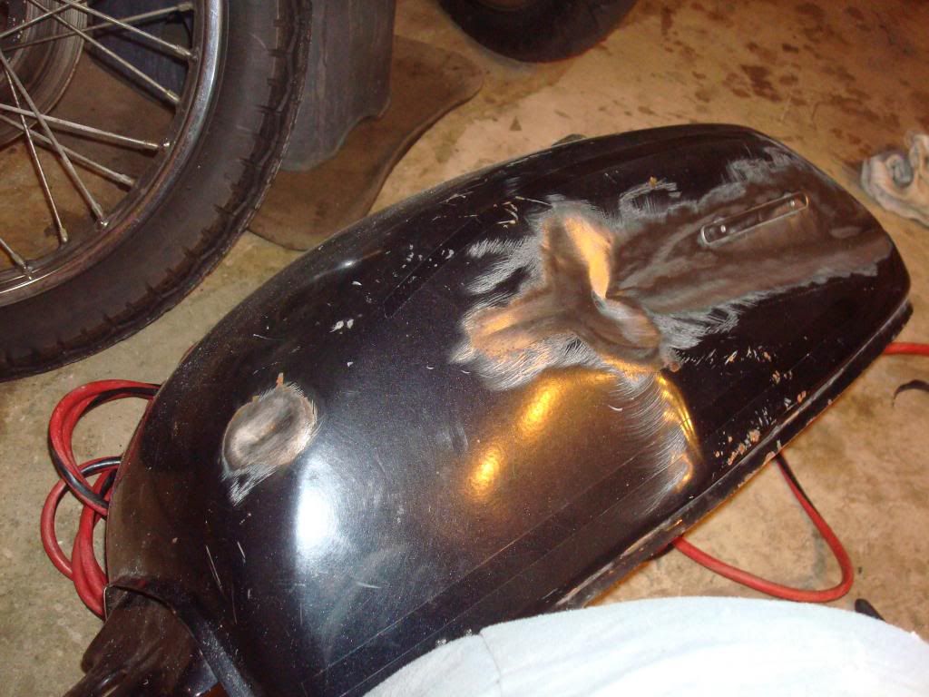

I picked up a HF stud welding gun a month or so ago to see if I could pull a huge crease out of a CX500 Deluxe tank I had. The first couple of photos will give you an idea of what I'm up against. The inside of the tank is totally rusty too. Whether or not I can restore it to use is less important to me than seeing how well the stud welder works. The tank looks like it was dropped in a trailer.

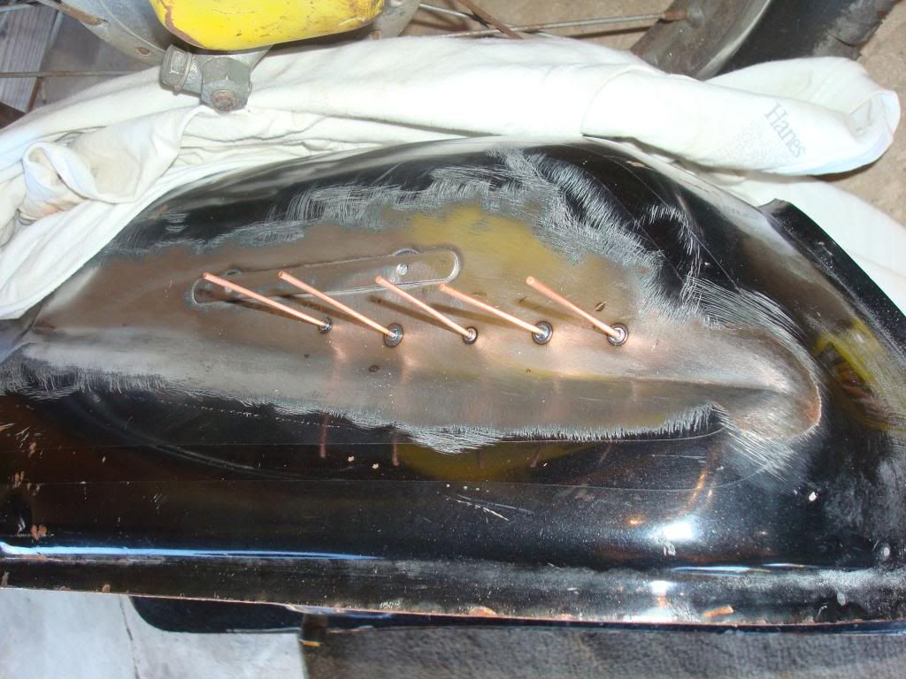

My first weld. I had no trouble at all with the welding process. The first thing I expected was to trip a breaker but all went well.
Now a small row
The dent puller works by grabbing the stud with a small thumb wheel. The reviews on HF are really tough on the dent puller and while it does seem a little flimsy, it worked just fine for me. Matter of fact, it pulled some studs right out of the tank (revealing a big problem)

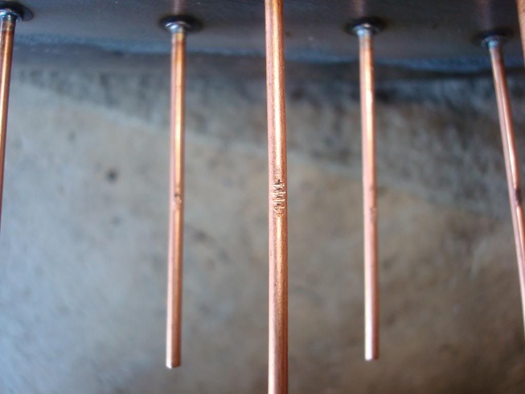

You can see in the photo where the dent is coming out by the angle of the studs.

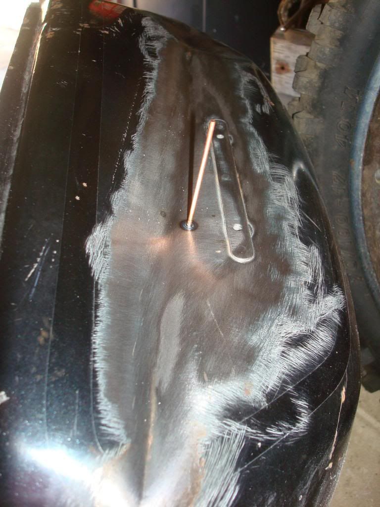

Now, I mentioned the big problem earlier. Here it is. The puller pulled the stud right off leaving a hole in the tank
In an application like pulling a dent out of a fender, it really wouldn't matter too much but a gas tank needs to be watertight obviously.
I ended up with a number of holes in the tank. I was under a second with each application of the welder and I went down to a fraction of a second on some of them. It was still hit and miss with pulling them off with the puller. I wasn't yanking on the puller real hard either.

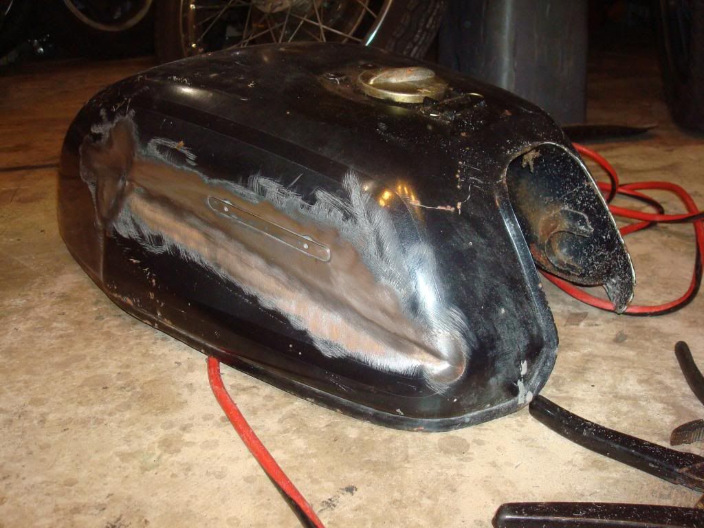

I cut the studs off with a hacksaw.
You can see the dent is pretty much gone. I will need to use a grinder to grind down the remaining parts of the studs and I hope I don't develop any more holes. As the tank sits, it's full of water and no leaks! With some body filler, I will be easily able to fade out the rest of the dent.
