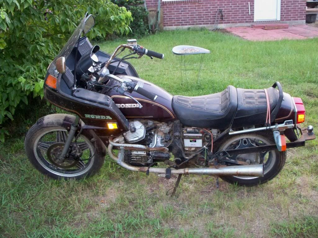

for a few minutes 'fore gas started running out of the right carb.
a friend gave her to me to fix up for my son-in-law. pulled the carbs and sprayed them out and cleaned the jets. sticky floats but i wanted to give it a try before sinking too much time it her. she runs! then died, but now i'll keep going. i want to strip it down to a regular silverwing. any tips on what i'll need?

Interesting looking bike. Must be a cross between a GL650, CX500, and GL500. Engine appears to be a 650, or someone painted it black, single disk front brake from a CX, and maybe some parts from a GL500. If it were mine, I would take it to a car wash and soak all the greasy areas with a engine cleaner or carb cleaner and spray that bugger down good. Then do it again. I just hate to work on dirty bikes.
Then get some chrome cleaner and some 0000 steel wool and brighten up the chrome. Best way is to remove all the chrome parts and polish them off. That will also give you the opportunity to rattle can the rusty areas of the frame and center stand. Take the fairing off too. There may be someone on here looking for a fairing, and the trailer hitch is interesting. I think Blindstitch was wanting one of those. You will need a headlight and bucket and mounting ears to go naked, but that is about all. Take the luggage carrier off if you want to.
As far as the engine, deep clean those carbs again, change all fluids (oil, brake, rear drive, coolant, blinker), check the cam chain and adjust (if it is a 650 engine, it has a auto adjuster), adjust the valves, sync the carbs, check the air filter, and brake pads. Then if the tires are OK, take it for a shakedown run.
Also list your bike's model in the signature line on the profile page, and your location. Someone may be close to advise and take some of your extra parts off your hands.

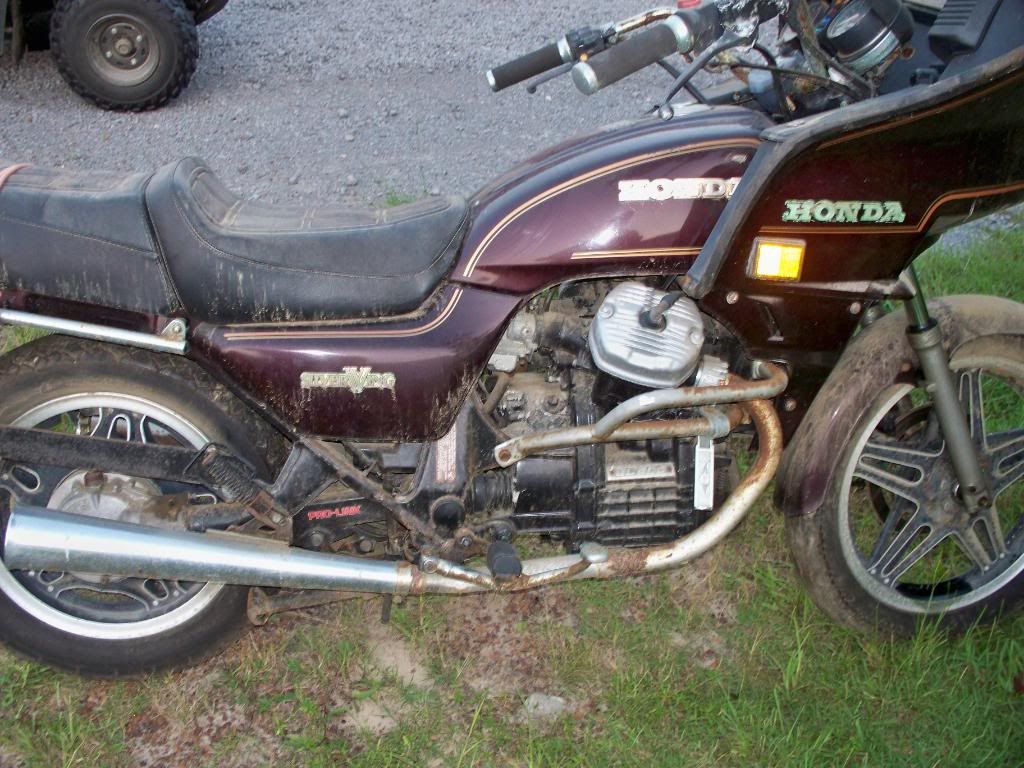

Blue, standard GL's had only the single front brake, That's clue #1, 2nd is the HONDA badge on the fuel tank. Interstate's didn't have those. Final clue is the absence of the tail light extenders although those could easily have been removed....
Engine looks like a painted 500, the badge visible is much smaller than we have on the 650's, and different layout, like this:
I don't think a 500 badge would fit on a 650 engine, they had a different mounting style.
clutch cover also painted black.
The side fins are also quite different from 500-650.

oh, it's a bitsa bike. he bought it from the local junkyard many many years ago. last month we pulled it out of his barn that had damage from hurricane rita in '05. hadn't run since '04 but he drained the carbs when he put it up for the winter. yeah, i cleaned it up. a lot. then started messing with it today. pulled the carbs back off. i'll soak 'em this weekend.

its a 500 thats for sure its a gl500 yep thats what it is if you look in the very first pic you can make it out
heres the pic
now then you tell me
