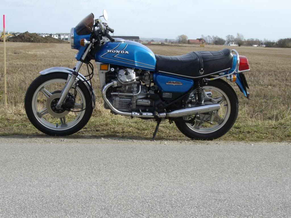

I completely understand how you feel about those bars - not only ugly but also giving a strange riding position. Seem to be US standard for that model. In Europe (also AUS, as i gathered) came lower bars, pretty straight and "sporty". Depends on your length etc, how well those bars would fit you. By adding a small aftermarket "thumbnail" screen to that instrument nacelle you´ll get some (limited but clearly noticeable) wind protection. That, together with a more leaned forward riding position could be pretty much what you´re looking for.
I went a small step further with mine: Upside-down mounted "clubmans" instead of European standard model bars. Together with the -1981 original "thumbnail" screen I´ve got quite comfortable riding position that never makes me especially tired. Of course butt sore, but that´s already one inevitable part of biking.
If you want it sort of original - replace those non-matching winkers / indicators with original-looking aftermarket stuff. Maybe also cut down the rear winker stalks - they look much better, shortened a bit, but will then be non-original.
Keep those "original" Hondaline engine guards - hard to find an look smarter than most other engine guards.
Two things I noticed from your pictures: The -79 wheels differ from the -78 ones. No black plastic "tabs" over the rim rivets. And also marginally wider rear. I´ve always believed there was a difference between -78 and -79 rims but never got it confirmed. Like the different brake fluid reservoirs. -78 round, -79 quare.
