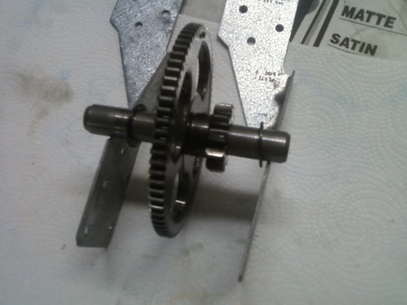

I reassembled and torqued it to 71 ft lbs on my torque wrench (used a cheater pipe wow!) and still have that much free play on on the starter gear with the rear cover off.
Heres pictures:
Gear to the back:
Gear to the front:
The starter gear with parts layed out:
Starter gear as set up ready to install you can see the two spacers:
In the first one you can see the space behind the flywheel.
Anyone got any thoughts?
Should I put the rear cover back on and see how it behaves?
8,422 Posts
According to those pictures there's still something wrong.The two Gears should have next to no gap and the smaller teeth on the Starter smaller pinion gear should mesh evenly and match to the larger gear.That still looks to me like the Flywheel clutch is not going down on the Crank shaft properly.
Are you sure all the parts are there?

I saw on the old forum somewhere that the washers are nominal 1 mm thick which is pretty darned thin.
I have about 1/4 inch of free play (more or less) I would guess without having measured it.
I do not think they are 1mm thick but I am not sure where to source new ones.
I will call fastenall and see what they have to say for themselves...
1,556 Posts
Discussion Starter · #19 ·
In those pictures above this one looks right,
So how was that fitted?
This image was taken with the starter gear on the pin and pushed as far back as it will go.
The other picture is to show that it will slide forward about 1/4 inch until it contacts the back of the flywheel.
The thing is when the rear cover is on I do not think the rear cover is capturing the gear and holding it in place relative to the flywheel.
I found that Ace hardware has machine bushings that are 1/2 inch ID 7/8 inch OD and .064 inch thick (14 gauge).
On the old forum I found a guy who says the washers are supposed to be 1 mm (0.039 inch thick (18 gauge)). I do not believe these are that thick.
If they are not I might go to Ace and buy a thicker washer to put on the front and see how it does.
8,422 Posts
There's still something not right about this.I have spare engine in my garage.I will take the rear case off tomorrow and take a couple of photos.I've never had to change/use anything but the stock Thrust washers on any of my engines and they are very thin.My digital calliper has crapped out so I cannot measure them.
