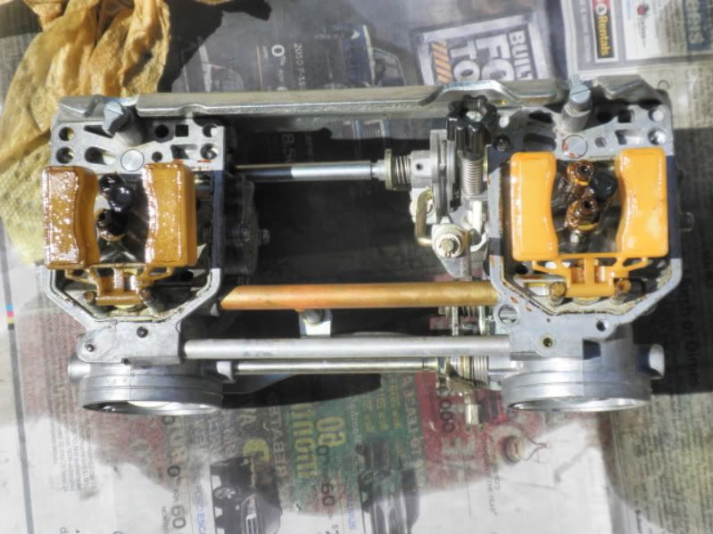

I wanted to start a new thread because this is going way beyond a seat latch. As I said before, this is to get my 1980 CX Custom back on the road after years of sitting and neglect. (Not by my hand!)
The tank has rust in it and will be coated. I pulled the carbs and they still had the old gas in them, and other stuff I can not describe. I guess there must be a trick to doing that as I read the thread on how to do it. I had to lossen the air box to get some clearance. After finding the secret bolt under the regulator. The carb on the left seems to be the master abd the right the slave. I will put the entire mess in a Pine Sol solution and let it start to soak. Don't know if this should be a 50-50 solution or more concentrated. Is this a good way to start this proceedure, using Pine-Sol? Will read the other thread on carb rebuilding. I could not get the bowls off so I tapped them with a plastic hammer. Now I kmow that there are two small allighnment pins on the two screws which break off when you apply lateral pressure! Now I know you need to do the gentle pry method instead.

BTW the Pine-Sol is working quite well. The throttle plates were "glued" shut and now opperate freely.

I am working on the carbs and want to know where to get the rubber plugs. As you can see, they are not reusable! They did not come with the rebuild kit. Actually, I can not believe that they built the carbs with rubber plugs. How about a a screw cap to plug the hole?
