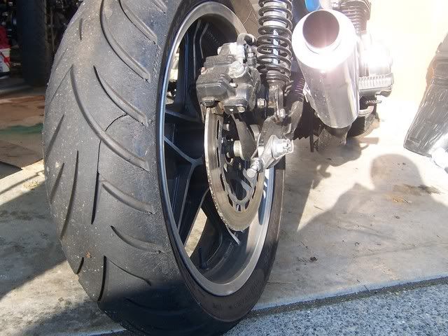

How much did it cost to have Kosman widen the wheels?
(this would be a nice upgrade for 130/80/17 radials on a 3.5" rim)

Cost was $520.00. Total with shipping.. Sandy Kosman retired and sold the shop. New owner but same great staff as before.. Since this was my sixth wheel modified by them, they gave me a deal..
I only sent them the one wheel that I had modified.. No need to send two.. They will weld on the wider lip.. Two choices of styles, the square lip or the round lip, I chose round.. I have square on my CBX & CB750F... My track CB750SC-F has kinda squarish round...

I've double posted in a few forums as well, so no worries. ... The rim weighs 18 pounds as pictured.. The front wheels is a 1982 GL1100 & is 2.5" wide x 18" diameter.
Only reason I went to this much trouble with 18" diameter is I wanted the largest diameter performance tire I can fit in the swingarm for top end speed..
A 160/60 or a 150/70 tire.. And no, I'm not going to Bonneville Salt Flats.. But Pacific Raceways for sure..

Here's what the 160 size Avon tire looks like... It is Sweet ! ! ! Still some room between the sidewall and the notched swingarm.. Maybe a 170 next time ..
The other tire is a stock size 130/90-16....

Is your tire mounted with the correct rotation??? It doesn't look right, but it wouldn't be the first time a tire manufacturer fooled me.
Hey Scudman, yeah, still lots of work to be done... The wheel is centered inline with the frame.. Being offset kind of spooks me.. I have not seen race take offs in the 18" size.. Most performance radial tires in 18 inch sizes are "Sport-Touring".. I have Avon on my other three bikes..
David, yes these Avon Storms are unidirectional tires.. They are mounted correctly..

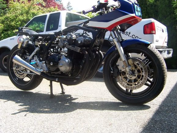

Is the 18" front wheel off of a GL1100?
Appreciate seeing your work!
Thx carolina... Yes the front is from a 1982 GL1100 Goldwing.. That was the only bike sold in the U.S. that had the "Reversed" Comstar in 18" x 2.5". I have this on my Track Bike CB750SC-F as well...

Dr John used to race a Guzzi with a 1" offset. He was sporting the #1 plate in the BOTT series back in the 90's. No handling issues with a single track vehicle. One of the reasons that I like to use 17" tires is so that my track tires fit my street ride. Unfortunatly the older bikes are all 19/18 so no good rubber can be found
I have that rim for the rear of my CX500 trying and I'm hard to make it fit and be safe. I also prefer the original Comstars. The spokes are too long for the 2.50" width and the rear hub. Honda made the draft angle on the side of the center ring flange different than the 2.15" x 18 rear.

Motivation.... Getting a bit hard to find these days.... I finally finished painting the frame and mounted the forks. New tapered steering head bearings & swingarm bearings... CB900F calipers, painted gold to match the rotors.. It now "rolls" around the garage.
Next up, Painting the engine, carburetor setup & install into the frame.... Now where did I put that other can motivation ?
very nice. one question... i had read (i believe on this site) that it was bad news to take these rims apart and try to put them back together. do you have any worries about the rim holding up? what did you use to put it all back together? did you find rivets that work or did you bolt them?
....... do you have any worries about the rim holding up? ........ what did you use to put it all back together?
Not worried at all... I replaced the five bolts with heavy duty allen head and the 10 rivets were replaced with standard grade steel allen head.. All with nylock nuts.
When cutting the original bolts, they felt a lot "softer" than what I replaced them with.. So, not worried at all... And you know, as with all of my bikes, this bike WILL be Track Tested, at Pacific Raceways, Auburn, WA.
