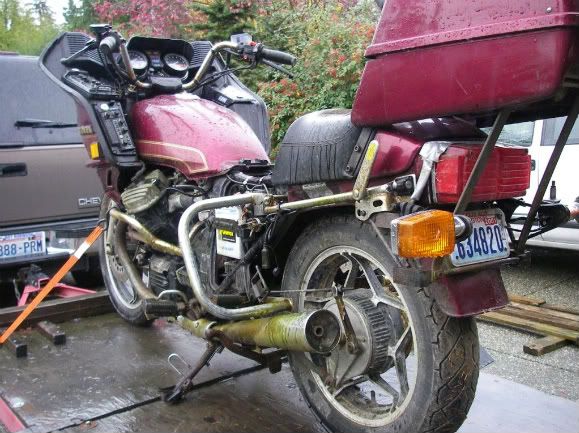

Well, I have finally rolled the 650 into the garage.. ... This is what it looked like 3 years ago when I brought it home...
