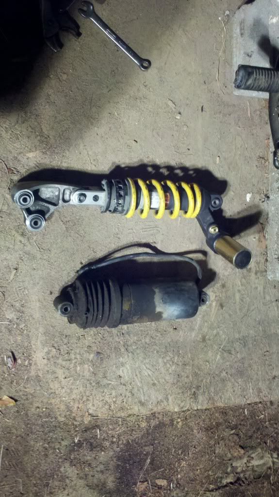

I'm contemplating changing out the air mono-shock of my gl500 and replacing it with a later spring shock from maybe a CBR or something from the newer sport bikes. I have not taken any measurements neither do I know them but am curious if you have any more information regarding this. I think it would give the bike a nice modern touch with my cafe build.
i did it. used a shock from a cbr600rr. simple bolt in install.. have to cut a small notch out of theupper mount so the reservoir will fit but its simple enough.

[quote name='Trooper' date='14 December 2011 - 01:13 PM' timestamp='1323897211' post='133508']
It's important to note that trooper's bike is already a ways off of stock. The biggest problem you would run into with a stock bike would be the airbox. He's running pods so not an issue.
