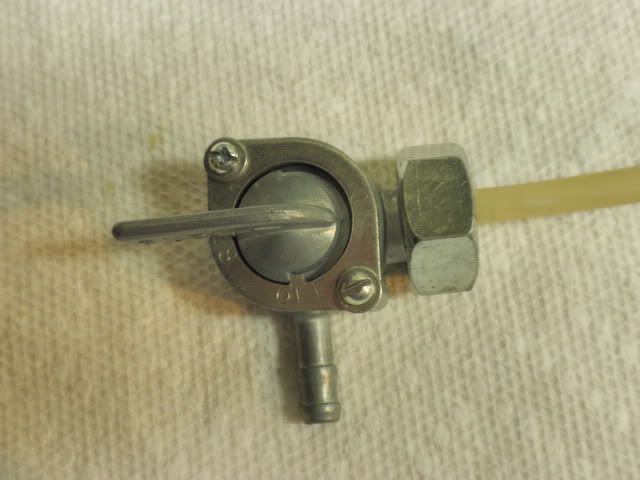

My goal was to finally get my bike on the road to find problems and dial things in before paint and some other detail work. I spent most of the day checking fasteners, bleeding brakes, checking connections, etc. in preparation for the big event.
Sadly, I couldn't get it to start. No matter what I did, I couldn't get fuel to the carbs. This isn't the original tank, so I haven't used it (or the petcock) before. I pulled the fuel line and confirmed that gas wasn't getting through the petcock. Off came the tank and petcock (no ride today).
Once I got the petcock off, I was amazed to see that NO FUEL came out of the tank! I cleaned the tank and sealed it with POR-15 about a year ago. Thinking that the tank was plugged, I gently stuck a screwdriver up the fuel outlet. Nothing - no resistance to pressure, no fuel, nada.
I am completely mystified by what the problem could be. The only thing that I can think of, which I can't confirm, is that the POR-15 created some kind of bubble (it would have to be a large one) that sealed off the area around the fuel outlet. For that to happen, there would have had to be a low pressure situation within the tank when the POR-15 was setting up. Not sure how that could have happened.
Any thoughts or suggestions?
Jeff

I think that I also will have this problem. Removed the petcock from the tank and all that was on it was the plastic tube.
Also was suprised that there was no screen or filtering media at all. So the question is, how do you remove the cemented in filter? Jam a screw driver into it and try to twist it out?
3
Uppon closer examination, the screen was still in there! I built a puller useing a 3/8 x16 bolt. Drilled out three washers to 29/64 inside diameter. It worked real slick. Did not have to tap the screen, just screw in the bolt. Now I suppose that I have to replace the screen!
I am glad someone posted this problem before I put gas in the tank!
I have an in line filter. It cost $5. The screen costs $23. I will use the in line and change it every year.
