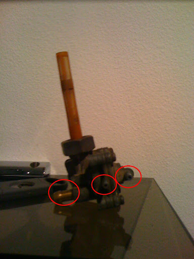

I have a question about the petcock...the larger outlet obviously goes to the the left side carburetor. But there are 2 other outlets on the petcock, one of which goes to the right sided carburetor. My question...which of those outlets goes to the right sided carburetor? It's been a while, and I can't remember which it is. Thanks.

The one on the far right of the picture goes to the carb fitting. The center one is just an air equalizing vent. The hose to that one goes down behind the swingarm pivot along with the rest of the vented hoses. It doesn't attach to anything.

Thanks!
