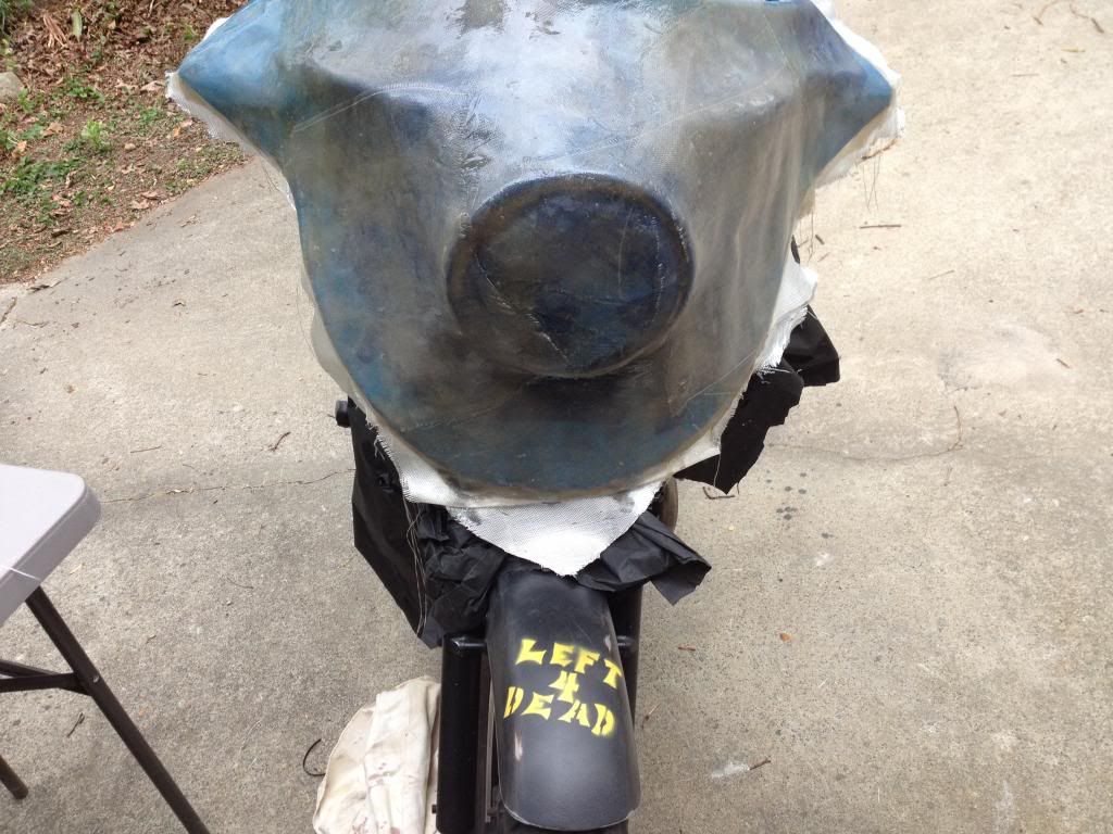

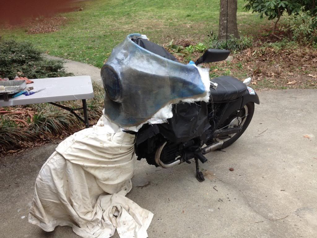

The fairing was pretty easy. I started out with PEX pipe to get the rounded parts into the general shape that I wanted and then covered the front of the bike and PEX with blue painters tape. That gave me a "buck" to lay my fiberglass on. After a few layers of fiberglass and resin, I let it setup for about 24 hours. I then pulled everything off the bike and removed the blue tape and PEX pipe from the underside of my part. I then used felt material soaked in the resin to build up the thickness of my fairing. I then spent sometime with Bondo body filler smoothing out the outside of the piece. I made it quite large to allow me to trim to fit the shape of the bike.
I will post the pics I have of the build. If you spend some time really shaping things out during the taping part you won't have to work so hard on the body filler part. This was my first attempt at building something like this, so I watched lots of vids on making parts from fiberglass on YouTube. Very helpful.
Everyone else is more than welcome to add their expertise on the subject and photos or links to vids on the subject.

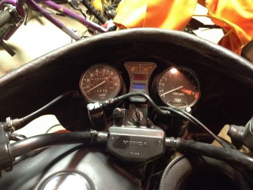

AWESOME work. It looks very symmetrical. How is the "fitment" (Is it a word?) for the gauges to the fairing INSIDE of the fairing?
Seems like a CX500 with the mini-fairing would have meshed up nicely with the inside of your custom fairing....
