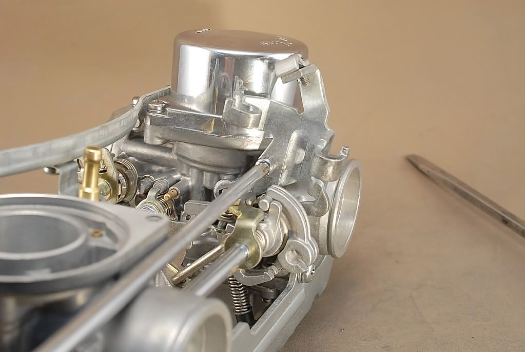

Just finished rebuilding my carbs. ( Thanks to Larry's Book) Fired up right away, gave it a few minutes to warm up before adjusting the idle. Problems is that it won't go below 1800rpm. if I twist the knob back up rpms will rise, but no matter how far I twist it down they will not fall past that? Checked the choke and it has to tension on it. What am I missing?
