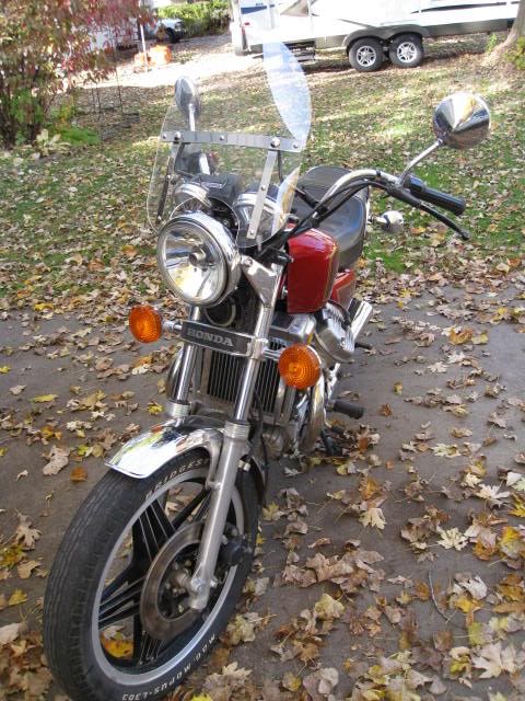

This may be old news but it was new to me. I needed a new headlight assembly for one of the bikes and didn't want to pay the big bucks for an OE unit, so I took a gamble and ordered one of these.
Clicky Clicky
The only thing I had to do was spread out the wires in the headlight bucket a little bit, since this headlight is maybe a 1/4" deeper than stock. Other than that just plug-n-play, it even uses the same H4 bulb so even replacement parts are available almost every where. The headlight in the link is marked "Off Road Use Only" not sure why, maybe the lens??? But the same guy has DOT approved headlights also. Oh, I offered $12 and change for the part and they accepted it, will they accept less??? Heres all his motorcycle lights

OK, after some aiming and riding I'm happy. The light gives off a bright white light, about your average good headlight these days. The shape of the beam looks about like the Bat Signal LOL, it's not bad just a little jagged around the edges. Think I'll take the Dremel to the doodad that sits just in front of the bulb (sorry don't know it's name) just smooth it out and maybe get a little more light just in front of the bike. Other than that it's good to go, when hitting bumps and RR tracks the light stays steady, no shaking at all.
I think the off road only bit is like WayneDW said, just hasn't gone through the tests in USA. It's not crazy bright, has a 55/60 Watt bulb and the pattern doesn't interfere with oncoming traffic at all. It's a keeper.

I like the original lens pattern better, and the bulb is really nothing special it's the same H4 type bulb as the stocker has. I guess it's a Cool Blue knock off but it just shines like your average halogen bulb. It might appear a little brighter but thats probably because it's a fresh bulb. For me, this was just a way to get a new headlight lens without spending $50+ for a used one.
