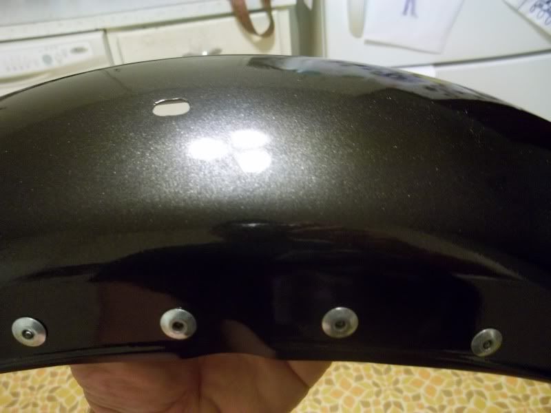

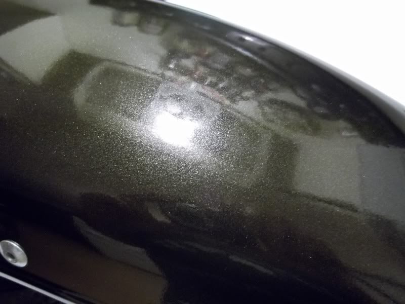

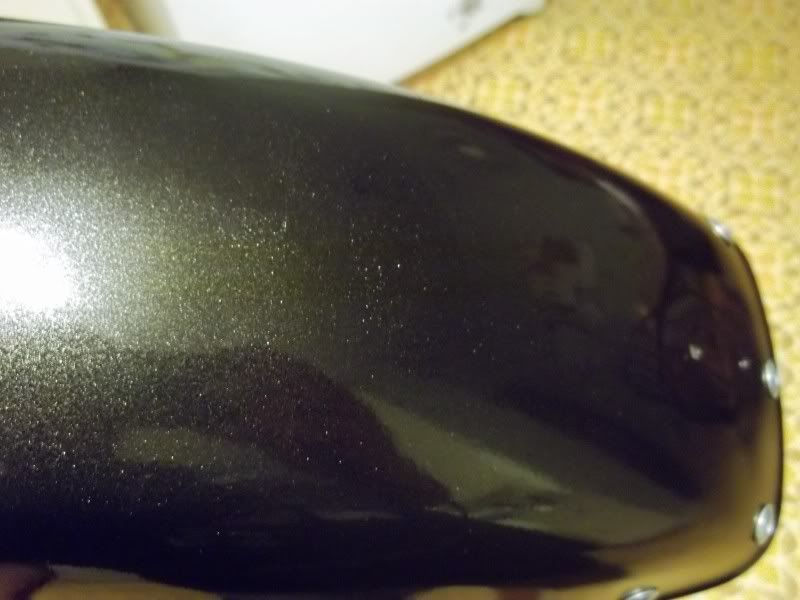

I just finished a new fender and painted it today with Duplicolor Perfect Match automotive rattle can. I did no sanding this time just scratch filler primer, black metallic, and clear top coat. The pics really do not do it justice. I tried to get a good enough shot so you could see how smooth and shiny the surface turned out. I couldn't get a shot that was real good because it's just in my kitchen with poor lighting but you can kind of get an idea. It's also hard to see how smooth it really is because of the metallic finish but trust me when I say this thing has no orange peel and is smooth as can be. Thought maybe you would be interested. Heres the pics:
I'll try to get some outside in the sun tomorrow.

It was a chrome front fender off of a Yamaha something or other. I cut and shaped it, drilled the holes for the rivets and mounting bolts, sandblasted it and scrubbed it with a wet scrub pad. Then I sprayed it with the primer and wet sanded that with 1200 grit. Dried it and painted it with the black metallic waiting 10 minutes between coats. I used 1 whole can. Then I waited 30 minutes and used almost a whole can of clear, again waiting 10 minutes between coats. I installed the rivets, put it on the bike and polished and waxed with Mcguires quick formula.

I can try. It's difficult to get a real good picture because of my cheap camera and also because of how the metal flake makes it almost look like a textured finish. When i'm standing there looking at it in the sun it reflects as good as any finish i've seen. I take a picture and it just never even comes close. I have had so many people ask me where I had the paint job done. Lots of shocked reactions when they find out I did it with rattle cans.
When I did my tank I spent over a week following the procedure I found online. I have like 32 coats on that thing and spent hours sanding. I just did not have the patience to do that on this fender so I did a quick job on it. I was completely done with all of the primer, the paint and clear within hours. And looking at the final product I really don't think that all of that sanding and the numerous coats looks all that better. In person the tank does have more shine, but i'm attributing that more to the many more coats of clear that I applied to it. I only used one can of color and about 3/4 can of clear on the fender. In any event i'm happy with it and it's good to the point that I feel proud to show it off.
