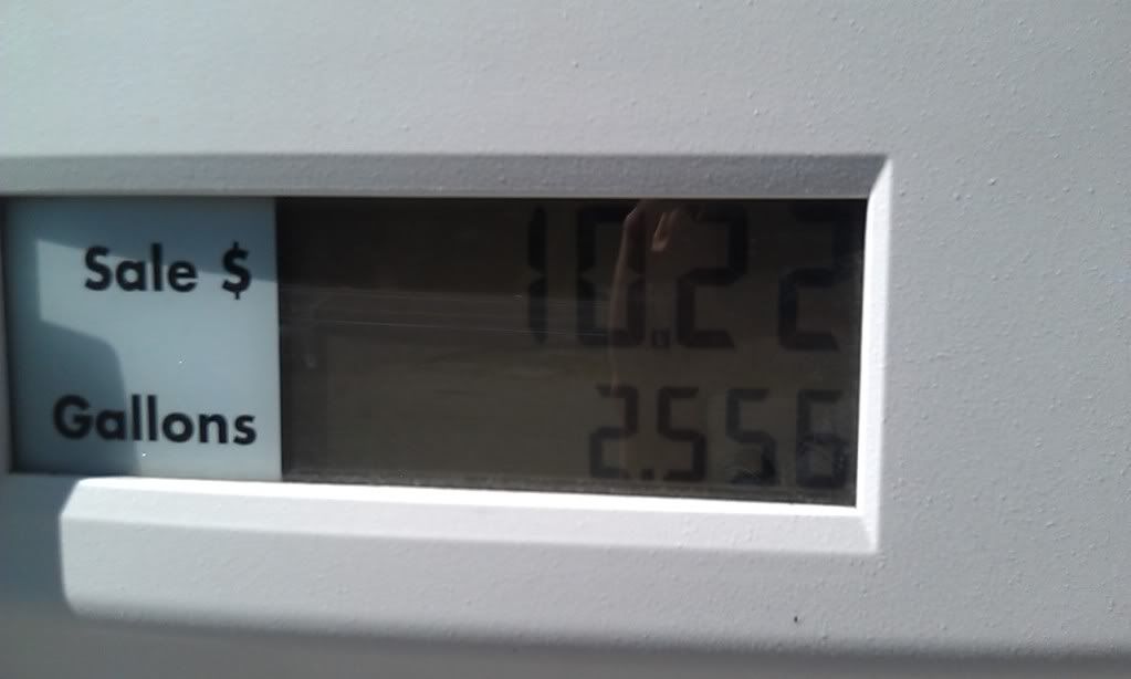

I went 137 miles
#3 ·
No, but I was sweating it for the last 10 miles. It was downhill out of Stevens Pass on US-2. Each right hand bend had me hoping for the gas station I knew was coming.
I swear I took a pic of the odometer, cuz I remember it saying 173. But the math doesn't make sense now... That would make 67mpg. The bike was loaded, as it was the first leg of 500 miles over the weekend. Could the extra 100 lbs on a long downhill have put me over 65mpg? I will have to do it again
#4 ·
Why? Wouldn't reserve take you to a gas station?
