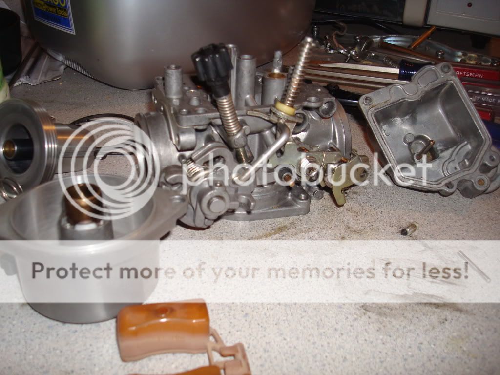

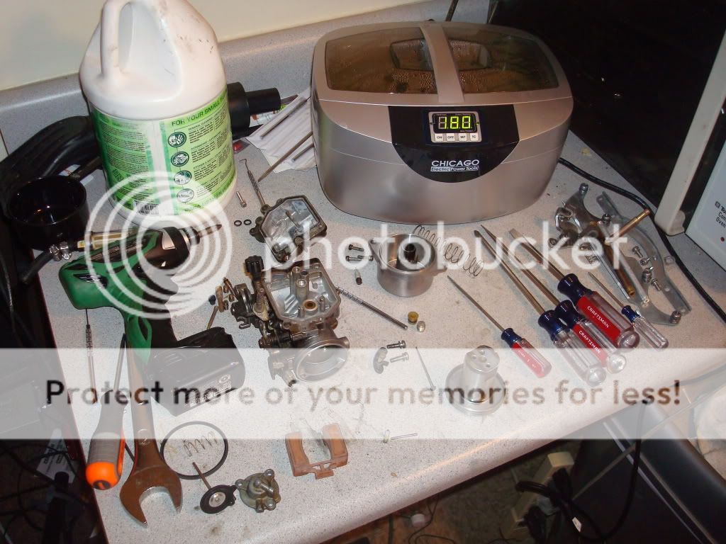

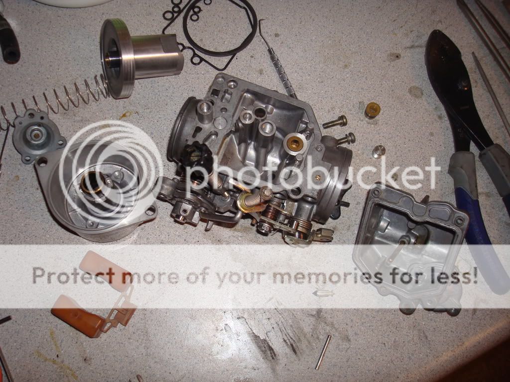

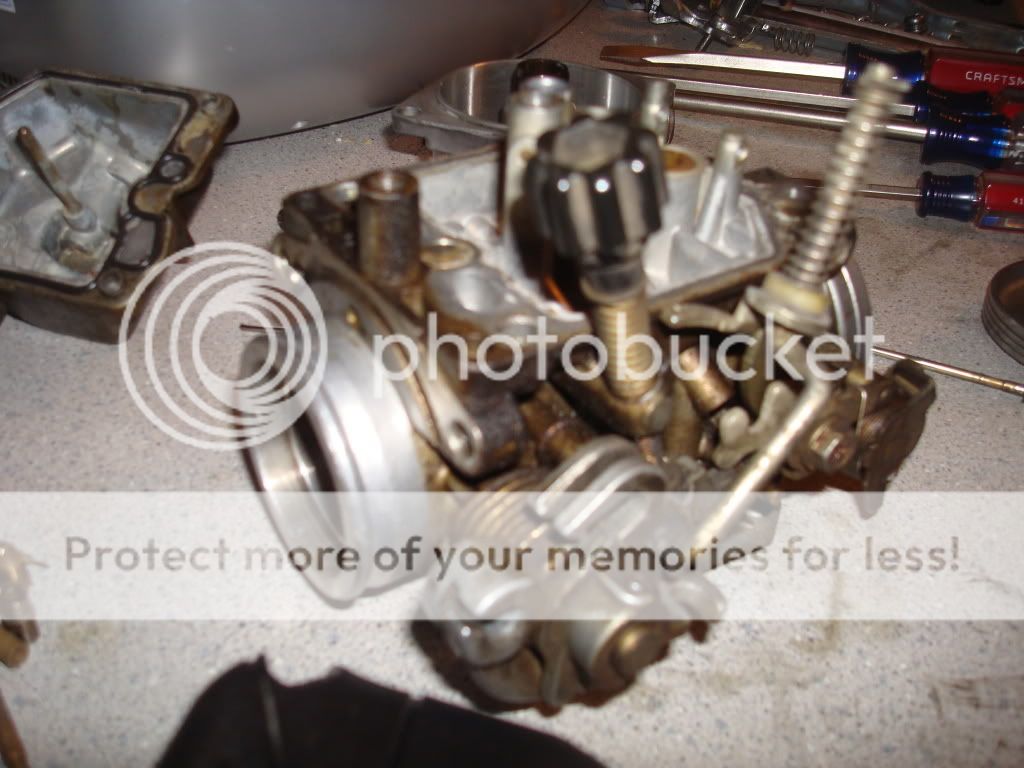

Hey guys. Ive been asking larry a few questions on another thread and thought I'd post my progress on another. So far Ive torn apart the left carb and cleaned it. I think I'm going to hold off here for a while until I get the replacement parts. Does anyone have experience with bike bandit's carb gasket kit? Does this include everything I'll want to replace? Or do you guys go about it another way? Ive attached some photos too (I hope) to show how well this machine does. With larry's book and this machine you can not go wrong.
I should also add that little impact driver, I found, worked better for me than that hand driver thing I bought :/
