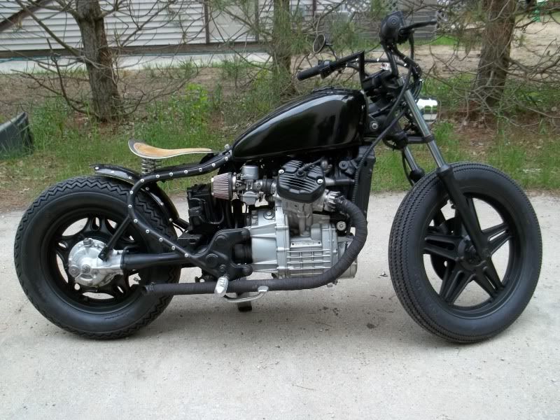

Hey fellas. Another update for ya after a week of riding all over creation with the vintage tires. Still no trouble. I've again ridden in the rain and anywhere the bike has taken me but nothing negative to report. These things handle every bit as good as the Dunlop 404's. The only thing I notice that I could consider a negative thing is they feel a little shifty at high speeds, like around 70 to 80 mph. Nothing crazy, it doesn't feel like i'm going to lose control but it doesn't seem quite as steady at those speeds. But to squirt around town and down country roads and winding backways they are great. I couldn't be more pleased. Heres a couple more pics. I had to raise the rear end of the bike about 2 inches because these tires expand at speed much more than the Dunlops did. I actually destroyed the first Indian Script I put on because it expanded and rubbed on the bar that my seat is mounted on. It completely chewed up the rubber all the way around about an inch wide. So I had to order another tire and raise up the bike a couple inches. I'll be back in another week or so to give another update. Later.

The CDI is in the stock location but I turned it around so I could route the wires towards the front of the bike. I did shorten all the wiring by a couple feet. Any extra I had is stored in a removable custom made compartment under the seat. Check these pics:
This is mounted here:
And the regulator is mounted under the support that the battery is sitting on. Sorry don't have a pic of that right now.
